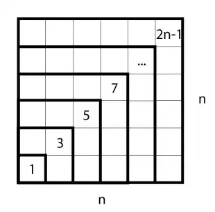

$$S_n=1+3+5+...+(2n-1)+(2n-3)+(2n-5)\\S_n=(2n-1)+(2n-3)+(2n-5)+...+3+2+1$$ sum of them is $2s_n$ $$2s_n=(1+2n-1)+(3+2n-3)+(5+2n-5)+...+(2n-3+3)+(2n-1+1)=\\(2n)+(2n)+...+(2n)$$ $n$ terms,so $$ 2s_n=(1+2n-1)+(3+2n-3)+(5+2n-5)+...+(2n-3+3)+(2n-1+1)=\\(2n)+(2n)+...+(2n)=2n \times n\\2s_n=2n^2\\s_n=n^2$$ another approach is visual proof :enter image description here
