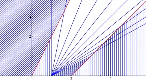

After the basic shock waves $x=t/2$ and $x=t+2 $ (shown in red) are accounted for, the characteristics look like this.
basic
This picture is correct for times $t<1$, but needs two adjustments after that. Note that the solution within rarefaction wave is $u(x,t) = (x-1)/t$.
Rarefaction catches up with shock on the right: $x=3$, $t=1$.

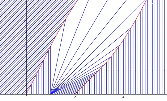

Plotting the new trajectories of shocks, and terminating the characteristics accordingly, we get the following picture (one has to look closely to notice the curvature of red curves).
final
Final battle: two shocks come together
At the time $t=6+4\sqrt{2} \approx 11.5$ (off the chart above), the two shock waves meet at $x=5+2\sqrt{2}$. At this moment, rarefaction ceases to exist. The single shock wave forms, separating the velocities $1$ and $0$. It propagates according to the equation $$ x(t) = 5+2\sqrt{2} + \frac12 (t-6-4\sqrt{2}),\quad t\ge 6+4\sqrt{2} $$
