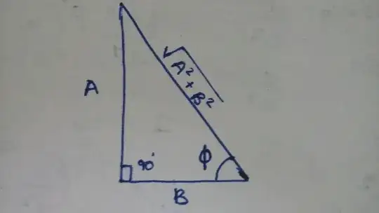

Now we just made an right angled Triangle with sides $$A,B,\sqrt{A^2+B^2}$$ Now in this triangle one angle was taken as $\phi$..and so the expression above was rewritten as
$$(\sqrt{A^2+B^2})(\sin(\phi)\cos(\theta)+\sin(\theta)\cos(\phi))$$ or popularly as $$\sqrt{A^2+B^2}(\sin(\theta+\phi))$$... while this is very clear to me but I haven't been able to get the idea of $\phi$ in the question ..it wasn't even in the question after all...it was like we just made it up!!..I think the triangle means something on the graph of sine or cosine or something like that.. so.does anybody know the graphical or intuitive or physical interpretation of the triangle and angle $\phi$ ??it must be having some special meaning..in the graph..atleast intuitively.. enter image description here

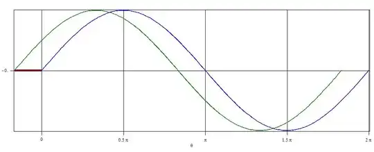

Here is an image comparing the graph of $\sqrt {{A^2} + {B^2}} \sin \left( {\theta + \phi } \right)$ in $\color{green}{green}$ with the graph of $\sqrt {{A^2} + {B^2}} \sin \left( \theta \right)$ in $\color{blue}{blue}$. The length of the $\color{red}{red}$ line equals the angle $\phi$ in radian.

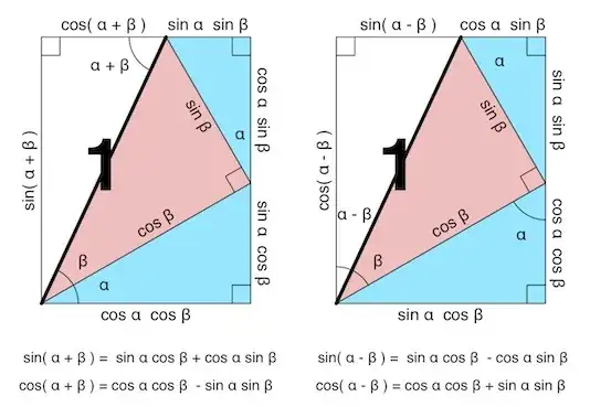

A nice geometric proof of this is given by Nelson in "Proofs without words", see picture below:
To understand it, construct the following picture around your triangle:
Sin and cos of sin
In the first picture above replace the pink triangle by your triangle with sides $A,B, \sin{A+B}$ and draw two triangles with angle $\alpha=\theta$.
Now calculate the lengths of the rectangle in terms of $A,B, \theta$, and then look at the white triangle.

    @Freelancer Intuitively i think that this picture explains well what happens there. As for the graphical question, which graph do you really mean? Do you mean $A \sin(\theta), B \cos(\theta), A \sin(\theta)+B \cos(\theta)$ or $\sin(\theta+\phi)$? Note that the question really boils down to the following: When we add two graphs together why do we get the third graph? And adding graphs is very hard to do "graphically"... – N. S. Nov 12 '15 at 14:39
