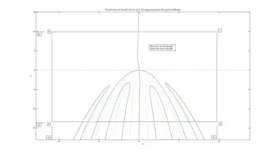

In the quotient formalism, if we divide a monic polynomial with positive coefficients with divisor $q(x)=x^{2}-ax-b$, the remainder is of the form $P(a,b)x+Q(a,b)$. I can show that $P(a,b)=0$ has one solution for large positive $b=b2$ and $n-1$ roots for large negative $b=-b1$ using Sturm chain. Equivalently, using Sturm's chain I can show that $Q(a,b)=0$ has two asymptotic solutions for $b=0$ on the lower half $a/b$ plane, as well as $n-2$ solutions for $Q(a,b)=0$ for the large negative $b=-b1$. I am certain that for large negative $b=-b1$, the solutions of $P(a,b)=0$ and $Q(a,b)=0$ interlace. Since the zero contours form connected curves, applying Jordan's curve theorem in the rectangle ABCD, A=[-a1 -b1] and C=[a2 b2] for will force at least once intersection of $P(a,b)=0$ and $Q(a,b)=0$ inside the rectangle, thus proving the theorem. **I have not being able to show the interlacing yet. Can someone please help me with relevant ideas or existing previous work regarding the interlacing?
enter image description here Please open the image in new tab for easier viewing

$Q(a,b=0)=Constant \ne 0$. So $Q(a,b=0)=0$ does not have any solution for $a$. However, by using the transformation $b=ma$ and using the recusrion formula, we can show that $$\lim_{m \to 0} [P(a,m)-n \ (1+\epsilon(n-1,s)) s^{n-1}] = \lim_{m \to 0} [Q(a,m)- \frac{ \ (1+\epsilon(n,s)) \ s^{n}}{m}]$$ With some work, this directly shows that $Q(a,b)=0$ has two asymptotic solutions along $+a$ and $-a$ in the lower half $a/b$ plane.
Using Sturm chain, it can be proved that large negative $b$, $P(a,b)=0$ has $n-1$ roots and $Q(a,b)=0$ has $n-2$ roots. This happens because the coefficients of the polynomial of $a$ increase in magnitude with decreasing power and changes sign after every second power I have a feeling this is the basic structure behind the Fundamental Theorem of Algebra, since sign change over four consecutive powers is what complex numbers are cpable of producing
The vertical sides of the rectangle ABCD can be directly estimated by taking a lower and upper limit of the roots of $P(a,-b1<b<b2)=0$, in presence of interlacing.
Part 3. What is left We need to show that for large negative $b$, the $n-1$ roots of $P(a,b)=0$ and $n-2$ roots of $Q(a,b)=0$ interlace. I am certain it can be used by comparing $l_{k}$ and $p_{k}$ and using the recursion formula. If there is an easy way to prove this from the recursion formula, it will be great.
