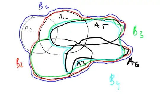

If $(A_n)$ is an increasing sequence of set (i.e. $A_{n}\subset A_{n+1}$), it's very easy to have an interpretation of $\bigcup_{i=1}^\infty A_n$. Same, if $(C_n)$ is decreasing (i.e. $C_{n+1}\subset C_n$), it's very easy to have an interpretation of $\bigcap_{i=1}^\infty C_n$. Both are very intuitif.
But if we are not in such ideal condition, we can try to get such condition in the way of the draw. The $B_i$ I have drawn are such that $(B_n)$ is decreasing, and thus $\bigcap_{n=1}^\infty B_n$ has now an intuitif sense, and we call it the $\limsup A_n$.
(ez)
Now you have to imagine that our sequence of set is infinite and reproduce the same schema.
I hope it's more clear (sorry for the bad quality of my draws, put it's complicate to draw on the computer.)
