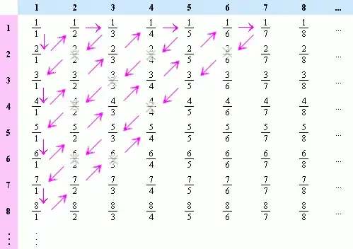

Suppose for a moment that we look at the $\epsilon = 1/8$ covering, so that at most $1/2$ of $[0,1]$ is covered. Suppose we also that our enumeration of the rationals is the standard one of Cantor, i.e.
http://www.homeschoolmath.net/teaching/rationals-countable.gif
It might be easier if we don't remove duplicates (still a proof of denumerability) so that we know the general $n^\text{th}$ number easier.
Then my question is: can we explicitly find an irrational not covered by one of the $\epsilon$-balls? Perhaps it's deceptively easy. Can we find many?

  • Note that the irrational would be very much dependent on the enumeration chosen. Also if you need to convince yourself that $\mathbb Q$ is of measure zero, think about is as a countable union of disjoint singletons. – Asaf Karagila May 30 '12 at 06:34

The irrational number $\phi=(\sqrt5-1)/2$ has the property that $$|\phi-(p/q)|\gt1/(3q^2)$$ for all integers $p,q$ so you can certainly choose your enumeration and your epsilons in such a way as to avoid covering it.
