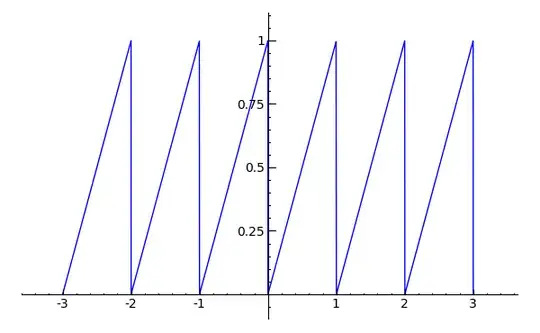

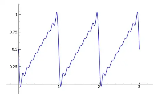

Plot of $f(x) = a_0 + \sum_{m=1}^{10} b_m\sin(2\pi m x)$, (summation from m=1 to 10).

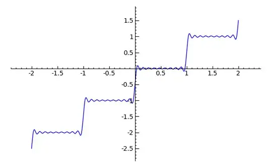

A plot of ⌊x⌋ (using finite number of terms as above)
Notice also, it is valid only for $x \in \mathbb{R}/\mathbb{Z}$. Because although ⌊x⌋ is continuous on $\mathbb{R}/\mathbb{Z}$. It has a jump of one unit at each integer.
