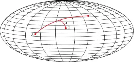

Now I'm trying to figure out the length of the geodesic line d between the given geodesic AB and the point C.
Is this the same problem as in the given question? Am I overthinking this?
For illustration
Ellispoid

It seems that the math behind this is more complicated than I thought it would be (please correct me if I'm wrong).
I found a very good paper by Charles F. F. Karney called Geodesics on an ellipsoid of revolution which not only explains the forward and inverse geodetic problem but also explores other problems on ellipsoids such as finding the shortest distance from between a point and a line (geodesic between two points) on an oblate spheroid.
