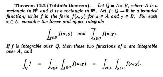

I think I might have to use these theorems in the proof.

  • This looks like Fubini's theorem (for Lebesgue integrals) to me, did you have a look at that? Your approach is wrong because you assume the existence of the set D, but you have to show that such a set exists. – Martin R Oct 19 '15 at 06:43
  • @MartinR I added the Fubini's Theorem as given in the text, but I'm not sure how this can help prove this. And why do I have to show that such a set exists? Isn't the problem saying that if $D$ is any set of measure zero in $R^k$ then $f(x,y)$ for $x\in A-D$ would be integrable over $B$? – nomadicmathematician Oct 19 '15 at 12:27
