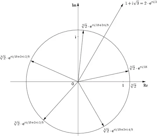

Keep in mind the four quad-roots of 1: 1, -1, i and -i. Any of these, raised to the fourth power, equals 1.
If you haven't encountered the complex plane yet, it will make visualizing these types of relations much much easier. Just like the number line did when you first started learning negative numbers.
Plot a number on the complex plane, determine the counterclockwise angle from the x axis (the positive real axis) to the number you've plotted—don't actually measure the angle, but observe it—divide that angle by whatever root you're taking (3rd root -> divide the angle by 3) and you have the angle of ONE of the answers. Draw a ray from the origin through that angle, and then two other rays making for a 3-symmetrical design, and you have the angles of the other two answers.
Here is an image for fifth roots. For the purposes of understanding my description of the visualization process, the numbers on the diagram are unimportant. enter image description here
Wildcard
  • 3,069
  • Yes, I know about Argand diagram. But I think the answer you've given here is the solution of $x^{\frac23}=-1$ which is not the same. There should only be one root. – Omur Oct 14 '15 at 08:36
  • No, it doesn't matter what the number is. I was just giving an example for 3rd root. For (-1)^(3/2): Start with -1, observe the angle (180 degrees), multiply by the numerator of the exponent (180 times 3 = 540 which is equivalent to 180), then divide by the denominator of the exponent (180 / 2 = 90) and add in the symmetry lines for the other answers. (2nd root means 2-symmetry, so -90). Since the magnitude of the original number is 1, that doesn't change, so the two answers are i and -i. (1 at 90 degrees and 1 at -90 degrees.) – Wildcard Oct 14 '15 at 18:48
