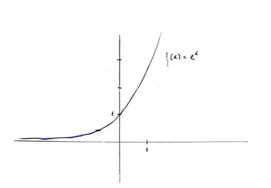

  • The function $f \colon \mathbb{R} \to \mathbb{R}$ defined as $f(x) = e^x$: e^x
    The image of $\mathbb{R}$ under $f$ is $(0, +\infty)$. This function gets arbitrarily close to $0$ as $x$ tends to $-\infty$, but never attains that value; this is what causes the image to not be closed. This is a continuous function on a closed but unbounded set.

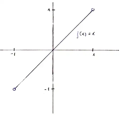

  • The function $f \colon (0, 1) \to \mathbb{R}$ defined as $f(x) = x$: x
    The image here is $(-1, 1)$. The cuplrits for the non-closedness of the image are $-1$ and $1$; again, the function approaches these values but never actually reaches them. This is a continuous function on a non-closed (and in particular, open) and bounded set.

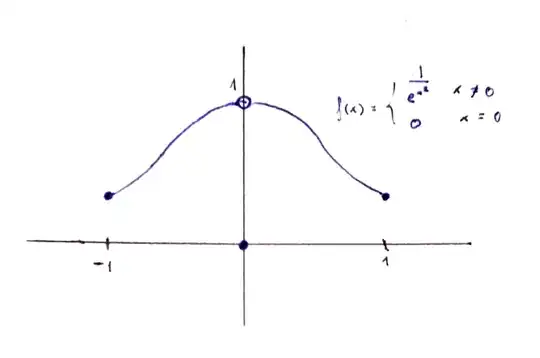

  • The function $f \colon [0, 1] \to \mathbb{R}$ defined as $\displaystyle f(x) = \begin{cases} \displaystyle\frac{1}{e^{x^2}} \quad &\text{if $x \ne 0$} \\ 0 \quad &\text{if $x = 0$} \end{cases}$: 1/e^x^2
    Here the image is $\{0\}\cup [\frac{1}{e}, 1)$. Once again, $f$ approaches 1 but doesn't reach it. This is a discontinuous function on a closed and bounded set.
