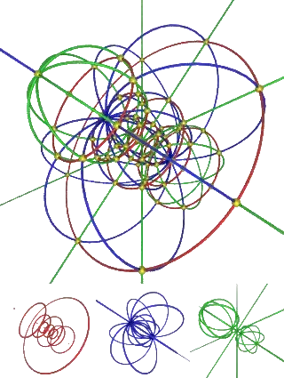

This image is from wikipedia,
3-sphere
The caption says that this is a "Stereographic projection of the hypersphere's parallels (red), meridians (blue) and hypermeridians (green)". I don't get that at all. What is a parallel, meridian, hypermeridian? Why can't we just

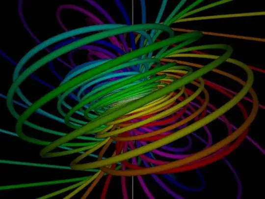

Here there is an image of the "Hopf fibration of the 3-sphere".
hopf
This looks very cool and there are formulas that break down the Hopf fibration into understandable algebra, but what does this mean, at a high level?

Now, as far as $S^3$ is concerned, your animation is just fine. You can think of the $3$ sphere as a movie starting with a point which grows to a unit $2$-sphere which then shrinks back to a point. This can be useful. Usually I think of $S^3$ as the one-point compactification of $\mathbb R^3$. (This is where stereographic projection comes in.) If you delete a point from a circle, you get a space homeomorphic to $\mathbb R$, and similarly deleting a point from $S^2$ yields a space homeomorphic to $\mathbb R^2$. This actually generalizes, and the formulas are not that hard to write down, to show that $S^n\setminus\{pt\}\cong \mathbb R^n$. So from a topological perspective you're not missing much by just looking at $\mathbb R^3$. Geometrically, this projection introduces a lot of distortion, so has to be considered carefully. For example, the Hopf fibration is a way to write $S^3$ as a union of geometric circles all of the same size, but when you look at the Hopf fibration translated into $\mathbb R^3$, the circles appear to be of different sizes, and one even turns into a line going through $\infty$.

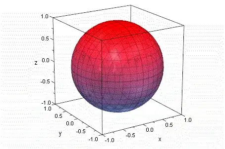

I first suggest starting with the lower dimensional spheres that you're already familiar with. Consider $S^{2}$ for example. It is the set of all points in $\mathbb{R}^3$ that satisfy the relation $$x^2+y^2+z^2=1.$$ Now, if we think of the $z$-dimension as time (I'll now refer to it as $t$), then we would have the relation $$x^2+y^2=1-t^2,$$ which would give us a family of circles (copies of $S^{1}$) with radii of length $\sqrt{1-t^2}$. So, if we consider $t=0$ to be our "initial position" in time, then we have a circle in $\mathbb{R}^2$ of radius $1$. Now, if we move "forward" or "backward" in time, then the quantity $\sqrt{1-t^2}$ will begin to shrink, until at times $t=1$ and $t=-1$ (one unit of "time" forward or backward) when we have the relationship $$x^2+y^2=0,$$ which is only satisfied by a single point in $\mathbb{R}^2$, namely $(0,0)$. So in this way, we can visualize $S^{2}$ as a number of copies of $S^{1}$ all glued together in a higher, third-dimension.

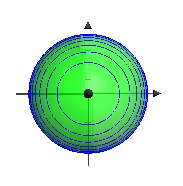

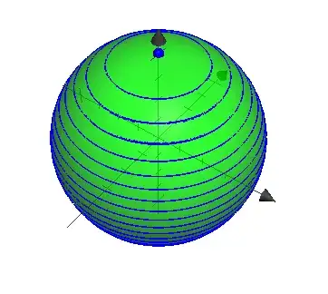

top view of $S^{2}$side view of $S^{2}$

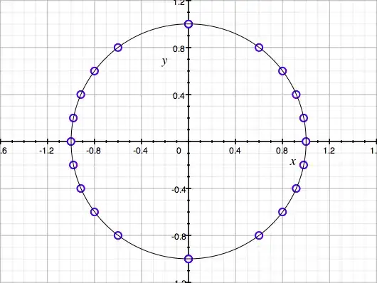

We can also do a similar process to construct $S^{1}$, which is the set of points in $\mathbb{R}^2$ that satisfies the relation $$x^2+y^2=1.$$ Thinking of the $y$-axis now as "time", we are left with the relation, $x^2=1-t^2$ or $$x=\pm\sqrt{1-t^2},$$ a subset of $\mathbb{R}^1$. So again we see that at time $t=0$, we have that $x=\pm 1$, which is exactly what we refer to as $S^{0}$. And again, we see that as we move forward or backward in time we have that $|x|$ becomes smaller, until we reach times $t=1$ and $t=-1$ where we have the only solution being the single value $x=0$. So in this way, $S^1$ can be viewed as a number of copies of $S^0$ being glued together in a higher, second-dimension.
