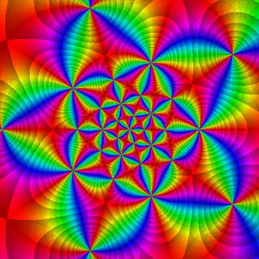

where the $f_{a,b}$ are in principle arbitrary normalization constants. As an example, here is a color wheel graph of $F_{5,3}$ stereographically projected into the complex plane where the icosahedral symmetry is apparent:
Icosahedrally symmetric rational function F_(5,3)
