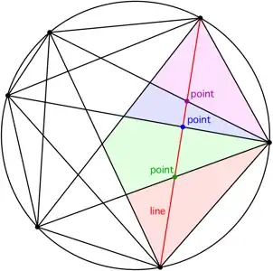

Let's assume that no three lines intersect at the same point.
Consider what happens each time you add a line between two points. If it crosses $k$ other lines, it splits $k+1$ regions into two, thereby adding $k+1$ regions. Therefore, when a line is added, it can be considered to be adding $1$ region for the line and $1$ region for each point of intersection:
$\hspace{4.5cm}$chords $$ \text{Regions Split by a Line}\atop\text{Each Region is Paired with a Line or Point of Intersection} $$ Thus, we just need to count $1$ for the original region inside the circle, and add the number of lines, $\binom{N}{2}$, and the number of intersections, $\binom{N}{4}$.
Thus, there are $\binom{N}{4}+\binom{N}{2}+\binom{N}{0}$ regions.
