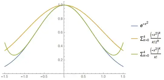

I was interested in one of the topics on this website, while I noticed a notation that I haven't been able to understand. This is the original question. One of the answers to the question states that $$ e^{-x^2}=1-(1/2)x^2+(1/2)(1/4)x^4-(1/6)(1/8)x^6+(1/24)(1/16)x^8+\cdots $$ I don't see how my answer would be different from his. Mine involved simply substituting $-x^{2}$ instead of the $x$ in the regular $e^{x}$'s expansion, yielding : $$ e^{-x^2}=1-x^2+(1/2)x^4-(1/6)x^6+(1/24)x^8+\cdots $$ Thanks for taking the time to read it through.

    the first equality is wrong. it looks like the expansion for $e^{-x^2/\textbf{2}}$ – tired Oct 05 '15 at 17:48
    The original answer looks wrong to me. The Taylor polynomial of a function to order $n$ is unique, and yours is correct... – Chappers Oct 05 '15 at 17:48

Plotting the three functions show that you are correct. The first one would be a series of $e^{-x^2/2}$
