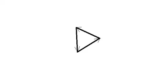

From the point of view of complex addition and absolute value the complex numbers behave like vectors. If the lengths of the vectors are the same and if the resulting vector is $0$ then the vectors (the first one is originated at $0$) form a triangle. A triangle with sides of equal length cannot be anything else but an equilateral triangle.
