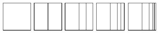

Here's a related example (and hopefully a little bit easier to picture): Take a unit square. Cut it in half vertically down the middle -- forming two pieces. The area clearly remains the same, but the total perimeter (counting both pieces) has increased by 2. Keep cutting the right-most piece vertically down the middle forever. The area remains unchanged throughout, whereas the perimeter is $4+\lim_{n \rightarrow \infty} \sum_{i=1}^n 2=\infty$.
alt text
Now, if you wanted to make it look more like a horn, you could move the pieces around, for example:
alt text
which still has area 1 and perimeter infinity. If you wanted to make it have volume 1 and surface area infinity, replace "square" with "cube".

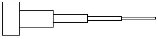

I found this explanation illuminating. It's from Jerome Keisler's Elementary Calculus.
Suppose you have a clay cylinder with radius 1 and length 1. Its cross-sectional area is $\pi$, so its total volume is $\pi$. The surface area, not counting the ends, is $2\pi$.
Now roll the cylinder with your hands so that it is only half as thick as it was. Its radius is now $\frac12$, so its cross-sectional area is only $\frac14\pi$. The volume must remain the same, so the cylinder's length is now $4$, and its surface area, again not counting the ends, has doubled, to $4\pi$.
You can repeat this process, rolling it into a snake with radius $\frac14$. Its length then increases to $16$, and its surface area doubles again to $8\pi$.
At each step as you roll the cylinder into a thinner and thinner snake, the volume always remains constant, but the surface area increases without bound. A snake with a radius of $r$ has a length of $\frac1{r^2}$ and a surface area of $\frac{2\pi}r$, both of which go to infinity as $r$ goes to zero. None of this should seem surprising.
Now instead of rolling the whole snake, just roll the right-hand half of the snake at each step. The volume is still constant, as it must be, and the surface area still goes to infinity. The shape you get is quite similar to Gabriel's horn.
