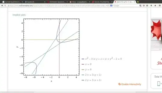

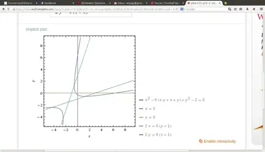

For $A \geq 3,$ we refer to what is usually called Vieta Jumping on this site. First, two diagrams, for $A=3$ and then $A = 6.$
The approach of Hurwitz (1907) says that, if there are any positive solutions for a certain $A,$ then we may keep reducing $x+y$ by either $$ x \mapsto A(1+y) - x $$ or $$ y \mapsto A(1+x) - y, $$ until such time as either: one of (exactly one of, not both) $x,y \leq 0$ or we reach a (positive) fundamental solution (Grundlösung) which satisfies both $$ 2 y \leq A (1 + x), $$ $$ 2 x \leq A (1 + y). $$ As indicated by the graphs, for $A \geq 3$ the Hurwitz arc lies just outside the first quadrant. However, the branch of the hyperbola we are examining always has $x > -1$ and $y > -1,$ which is to say that there are no integer solutions with $xy < 0.$ Or, with $xy < 0,$ $(x+1)(y+1) \leq 0,$ so $xy+x+y \leq -1,$ while $x^2 + y^2 - 2 \geq 0.$ Oh, if $y=0,$ then $x = (1/2 )(A \pm \sqrt {A^2 + 8});$ this is rational only with $A=1.$
