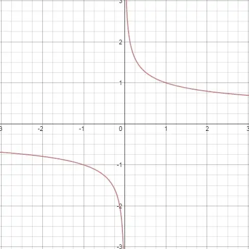

Let $f(x)=x^{-(1/3)}$ and $A$ denote the area of region bounded by $f(x)$ and the X-axis, when $x$ varies from -1 to 1. Which of the following statements is/are TRUE?
  1. f is continuous in [-1, 1]
  2. f is not bounded in [-1, 1]
  3. A is nonzero and finite
I try to explain :
graph is :
  1. False , since left limit is not equivalent to right limit.
  2. True , since f(x) rises to $infinite$ at $x=0$.
  3. True , since we can calculate it by doing integrating the function
hululu
  • 4,913
  • is True. Where do you think left- and right-limits do not match, x = 0? But that's not in the domain, and as a delicate part of the definition, continuity (or discontinuity) only applies at points in the domain. So the limits match for all points in the domain, meaning it's continuous.
  • – Daniel R. Collins Sep 27 '15 at 07:07
  • And pretty sure 3. is False, because the definite integral does not converge. – Daniel R. Collins Sep 27 '15 at 07:10
  • My mistake on 3, I didn't read the bounds specification on A. It's also True. So they're all True. – Daniel R. Collins Sep 27 '15 at 07:38
    See here for note on restriction of continuity to points in domain: http://math.stackexchange.com/questions/1431796/if-a-function-is-undefined-at-a-point-is-it-also-discontinuous-at-that-point/ – Daniel R. Collins Sep 27 '15 at 07:40
  • As I read , this is a polynomial function , it should be continuous as well as differentiable (for this function), Am I rt ? – hululu Sep 27 '15 at 07:47
  • But official key says 1 is false see Q.no. 56 – hululu Sep 27 '15 at 07:54
    I would say that the official key is mistaken, given standard definitions of continuity. – Daniel R. Collins Sep 27 '15 at 17:15
  • This happened rarely , this is standard exam GATE GATE-16 – hululu Sep 27 '15 at 17:26
    @DanielR.Collins: $f$ is certainly not continuous on $[-1,1]$.It is continuous on $[-1,0) \cup (0,1]$, but that was not the question. – TonyK Sep 28 '15 at 11:10
  • @TonyK That's a good point, thanks for the correction. – Daniel R. Collins Sep 29 '15 at 05:45
  • I'm very very confused :( – hululu Sep 29 '15 at 05:45
