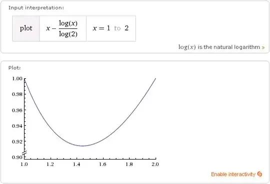

I want to address some trouble spots in your argument. This would be too long for the comments so I'll write it here.
1) Writing "$\cdots+0$" at the end of your infinite sums is incorrect. Just write "$+\cdots$", as in
$$ 1 + \frac{1}{2^x} + \frac{1}{3^x} + \cdots > 1.25. $$
Note that it is customary to write at least three full terms before the $"\cdots"$.
2) It is true that $xN - x + 1 > N$ when $N>1$ and $x>1$, but
$$ \inf_{x>1} (xN-x+1) = N, $$
so you have not made any progress; you may still only conclude that
$$ 1+\dfrac{1}{2^{x-\frac{ln(x)}{ln(2)}}}+\frac{1}{3^{x-\frac{ln(x)}{ln(3)}}}+ \cdots>N $$
for all $x \in ]1,1+\delta[$. In order for your argument to work, you would need a new lower bound whose infimum over the interval in question is strictly larger than your previous lower bound by some amount which is "large enough" so that when you repeat the process an infinite number of times the sequence of new lower bounds diverges to $\infty$.
3) Your choice $y = x-\ln x/\ln 2$ is actually less than $1$ for all $x \in ]1,2[$. At least it is less than $1$ near $x=1$, since $\frac{d}{dx}(x - \ln x / \ln 2) = 1-1/(x \ln 2) < 0$ for $x \in [1,1/\ln 2[$. Here's a plot from WolframAlpha:
In other words, the statement "$y \in ]1,1+\delta_2[$ for some $\delta_2 > 0$" is false, and you may not apply the argument again to these new values.
Please let me know if I could clarify anything further.
