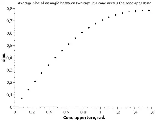

Using the Monte-Carlo simulation I got this curve:
Monte Carlo simulations of an average sine of an angle between two rays in a cone
