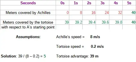

For example, the simple way mentioned earlier to solve the problem (not the paradox) can be examined using a spreadsheet. Given the assumptions in the diagram below, the time for Achilles to reach the tortoise is 5 seconds:
39 m / 7.8 m/s = 5 s
A simple solution for the problem
If we calculate a sum of an infinite series, as several mathematicians have suggested, we obtain the same result: Achilles will reach the tortoise. By applying any legitimate mathematical solution to the problem, we state, in another way that: We can prove that Achilles reaches the tortoise.

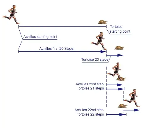

An example
The following is not a “solution” of the paradox, but an example showing the difference it makes, when we solve the problem without changing the system of reference. In this example, the problem is formulated as closely as possible to Zeno’s formulation.
Zeno would agree that Achilles makes longer steps than the tortoise. Let’s assume that one Achilles-step is about 20 tortoise-steps long, and let’s also assume that both Achilles and the tortoise make the same number of steps in the same amount of time. For example, two steps per second (the exact amount doesn’t really matter). If the tortoise starts the race 20 Achilles-steps ahead of him, then after 20 steps Achilles reaches where the tortoise was (See diagram below: Tortoise starting point).
No change of system of reference
In the meantime, the tortoise has made 20 of her steps, and she is now one full Achilles-step ahead of him. We have not changed our system of reference. We referred to both starting points. These did not move relatively to each other. We could choose any fixed ground point. To please Zeno, let’s continue by referring to the tortoise starting point, where Achilles currently is. When both runners make one more step, step 21, the tortoise will have moved by one of her steps and she will still be ahead of Achilles by that one tortoise-step. Achilles is now one Achilles-step ahead of the tortoise starting point. Now, let’s continue, without changing the system of reference. This is the key point. We do not redefine the problem and use the current positions of the runners as new starting points, as Zeno proposes, but we refer to the information about the race we have already accumulated in our knowledge base. Achilles then completes his 22nd step, and he is two Achilles-steps ahead of the tortoise starting point. The tortoise will have completed her 22nd tortoise-step from her starting point. Hence the tortoise is now behind Achilles by 18 tortoise-steps. Thus, if we do not change the system of reference, the paradox does not appear.
