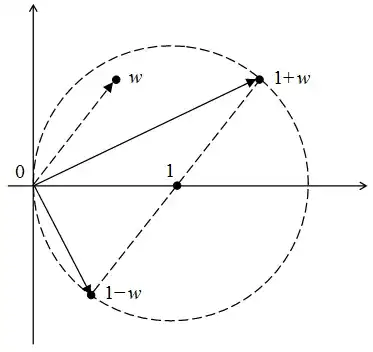

The picture shows a vector with dashed line representing the complex number $w$, and two vectors with solid line representing $1+w$ and $1-w$.
The line from $1+w$ to $1-w$ is a diameter of the circle with unit radius and center $1$. Therefore the triangle defined by $0$, $1+w$ and $1-w$ has a right angle at $0$.
The figure also illustrates that the right angle at $0$ is the sum of $\arg(1+w)$ and $-\arg(1-w)$. Thus $\arg z = \arg(1+w) - \arg(1-w) = \pm \pi/2$ (it will be $\pi/2$ for $\arg w > 0$ as depicted in the figure, and $-\pi/2$ for $\arg w <0$). Therefore $z$ is imaginary.

I prefer to read this proof the other way around, using the algebraic proof to verify that a triangle whose hypotenuse is the diameter of the circumcircle is a right triangle. – Mario Carneiro Aug 31 '15 at 18:39
@MarioCarneiro Your approach is neater :-) To add some variety, I wanted to offer a geometric argument. The fact that {a triangle with one side given by the diameter of the circle is a right triangle} is well known anyway – Luis Mendo Aug 31 '15 at 18:42
