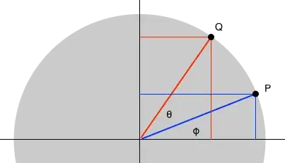

Consider what happens when we take a point $(x,y)$ and rotate it by an angle of $\theta$.
Using polar coordinates, we can write $(x,y) = (r\cos \phi,r\sin \phi)$ where $r$ is the distance from $(x,y)$ to the origin and $\phi$ is the angle made by the line from the origin to $(x,y)$ and the positive $x$-axis.
After rotating $(x,y)$ by an angle of $\theta$, the new point is still $r$ units away from the origin, but now, the angle made by the line from the origin to $(x',y')$ and the positive $x$-axis increases by $\theta$. Hence, $(x',y') = (r\cos(\phi+\theta),r\sin(\phi+\theta))$.
Now, let's use the cosine and sine sum of angle formulas to write $x'$ and $y'$ in terms of $x$ and $y$:
$$x' = r\cos(\phi+\theta) = r\cos\phi\cos\theta - r\sin\phi\sin\theta = x\cos\theta - y\sin\theta$$
$$y' = r\sin(\phi+\theta) = r\sin\phi\cos\theta + r\cos\phi\sin\theta = y\cos\theta + x\sin\theta$$
Putting this into matrix form gives us:
$$\begin{pmatrix}x' \\ y'\end{pmatrix} = \begin{pmatrix}\cos\theta & -\sin\theta\\ \sin\theta & \cos\theta\end{pmatrix}\begin{pmatrix}x \\ y\end{pmatrix}$$
Hence, the matrix which rotates a point by an angle of $\theta$ counterclockwise is $\begin{pmatrix}\cos\theta & -\sin\theta\\ \sin\theta & \cos\theta\end{pmatrix}$.

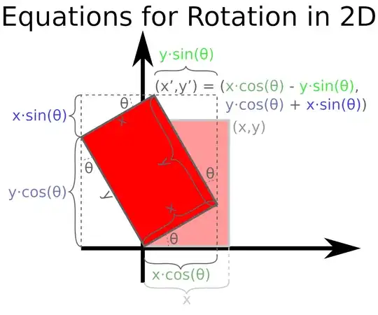

I came up with a visual derivation of the equations for rotation in 2D:
Visual Derivation of Equations for Rotation in 2D
Or alternatively in SVG vector format: https://upload.wikimedia.org/wikipedia/commons/b/b7/Visual_Derivation_of_Equations_For_Rotation_In_2D.svg
Coordinate $(x, y)$ is the top-right corner of the original rectangle in salmon pink, while the coordinate $(x', y')$ appears at the top of the darker red rectangle which has been rotated counter-clockwise by angle theta.
The components of $x'$ are $x \cdot \cos(\theta) - y \cdot \sin(\theta)$ marked in green, while the components of $y'$ are $y \cdot \cos(\theta) + x \cdot \sin(\theta)$ marked in blue.
$x \cdot \cos(\theta)$ is the projection of the bottom $x$ of the salmon pink rectangle onto the horizontal axis after counterclockwise rotation by the angle $\theta$ (it is the horizontal component of the rotated red rectangle's lower-right side), and is shorter than the original $x$.
$y \cdot \sin(\theta)$ is the projection of the salmon pink rectangle's $y$ side onto the horizontal axis after counterclockwise rotation by the angle $\theta$ (it is the horizontal component of the rotated red rectangle's upper-right side).
We subtract the shorter horizontal component $y \cdot \sin(\theta)$ from the longer horizontal component $x \cdot \cos(\theta)$ to obtain $x' = x \cdot \cos(\theta) - y \cdot \sin(\theta)$ which is the horizontal component of $x$ after counterclockwise rotation.
This can be rewritten in matrix format as discussed in wltrup and JimmyK4542's post:
