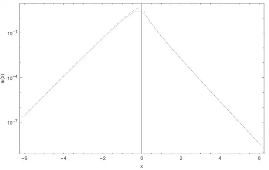

Edit-3: (makes Edit-1 obsolete). The function is real-valued and positive, see continuous line on the numerically produced graph. Dashed lines are $\sqrt{2} \, e^{-\pi x}/\sqrt{x}$ for $x \to +\infty$ and $20 \, e^{+\pi x} \sqrt{-x}$ for $x \to -\infty$, confirming the asymptotics derived by @tired.
graph of the function + asymptotics

  • @Slaviks are you u sure about $\sim\exp[-\pi x]$. a first short calculation gave me $\sim\frac{\exp[-\pi x]}{\sqrt{x}}$ which looks quite close in a logarithmic plot – tired Aug 13 '15 at 12:18
  • @tired No, I am not sure! I was checking a single exponential. For positive $x$ your $\exp[ - \pi x]/\sqrt{x}$ fits much better (less than 0.1% difference for x>5). For negative $x$, adding $\sqrt{|x|}$ makes the agreement worse. Would you like me to update the plot? – Slava Kashcheyevs Aug 13 '15 at 12:30

    I see what you did, excellent!! Simultaneously with your post, I have update the plot which confirms your asymptotics beautifully ($I(x)$ defined by @Leucippus equals $\psi(x)/\sqrt{\pi}$). – Slava Kashcheyevs Aug 13 '15 at 14:37
