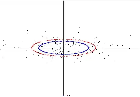

[update] Here I show the difference between the two concepts in a two-dimensional example. I generated slightly correlated random-data. Rotated to pca-position, such that the x-axis of the plot is the first princ.comp. (eigenvector) and so on.
The blue ellipse is that ellipse using the axis-lengthes of stddev of the principal components.
Then I computed another ellipse by minimizing the sum-of-squares of radial distances of datapoints to the ellipses circumference (just manual checking), this is the red ellipse. Here is the plot:
ellipsefitting
[end update]
