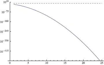

Below is a plot of the difference between the $n$'th partial quotient of the continued fraction and $\sqrt{2}$. Even for $n=3$ the error is found to be smaller than double precision $\sim 10^{-16}$ and one needs to use higher precision in the calculation to be able to find any difference. With higher precision I find that at $n=25$ the agreement is better than $500$ digits.
(source: folk.uio.no)

  • I guess this numerical analysis provides evidence that the continued fraction converges very fast. – Nicco Aug 04 '15 at 09:21
  • @Nicco Yes it does. One can compare it with $\sqrt{2} = \cfrac{1}{2+\cfrac{1}{2+\cfrac{1}{2+\ldots}}} - 1$. In this case one needs to go down to $n=130$ to get $100$ digits of $\sqrt{2}$. – Winther Aug 04 '15 at 12:37
