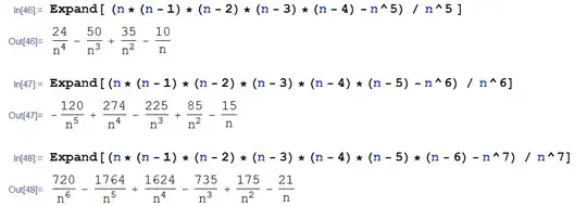

$$ \Bigg| \dfrac{\prod_{i=0}^{k-1} (n-i) }{n^k} - 1 \Bigg| \leq \frac{C}{n}, \forall k \leq n $$
How to find an expression for $C$ independent of $k$ and thus $n$? It arises in estimating the speed of convergence of exponential series and was mentioned in here for example. The suggestion there was to use the triangle inequality. It is clear that $n^k$ would cancel in the numerator, but the rest still seems to be something which grows with $k$. Any ideas or thoughts?
A numeric investigation of some terms shows that there is something like an exponential or geometric series which should converge. There needs to be an upper bound on such expressions independent from $n$.
