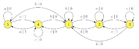

Here is a theoretical approach. I will slightly change your notation and take the alphabet $A = \{a,b,c\}$. Let us denote by $|u|_{ac}$ (respectively $|u|_{ca}$) the number of occurrences of the factor $ac$ (respectively $ca$) in $u$. Let $\delta: A^* \to \mathbb{N}$ the function defined by $\delta(u) = |u|_{ac} +|u|_{ca}$.
Step 1. Prove that $\delta$ is a sequential function and find a sequential transducer $\mathcal{A}$ that computes it. If I am not mistaken, this is one: enter image description here
The vertical bar is a separator and $\delta(u)$ is obtained by adding the outputs when reading the word $u$, starting from the initial state. For instance, if $u = acacabcacacb$, you get $$1 \xrightarrow{a \mid 0} 2\xrightarrow{c \mid 1} 3 \xrightarrow{a \mid 1} 2 \xrightarrow{c \mid 1} 3\xrightarrow{a \mid 1} 2\xrightarrow{b \mid 0} 1 \xrightarrow{c \mid 0} 4 \xrightarrow{a \mid 1}5 \xrightarrow{c \mid 1} 4 \xrightarrow{a \mid 1} 5 \xrightarrow{c \mid 1} 4\xrightarrow{b \mid 0} 0$$ and thus $\delta(u) = 8$.
Step 2. Let $$ L_m = \delta^{-1}(\{m, m+1, \dotsm\}) = \{ u \in A^* \mid \delta(u) \geqslant m \} $$ Then $L_m$ is a regular language and an automaton accepting this language can be computed by taking the wreath product of $\mathcal{A}$ and of the minimal automaton of the language $a^ma^*$ on the alphabet $\{a\}$. The resulting automaton has $5 (m+1)$ states.
