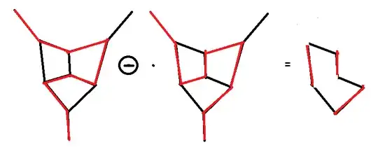

Morgan was right: I haven't checked simple counter examples. Here is one. A graph might contain 3 adjacent squares, which gives rise for two kinds of hamiltonian cycles and the symmetric difference is not another HC, but a seperated cycle.
