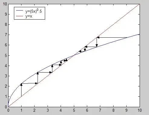

I draw a picture with $c=5$,which will help you to understand the question.enter image description here
