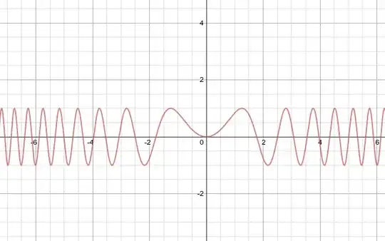

Consider $\sin(x^2)$. It is continuous and bounded but not uniformly continuous. This is because we can find arbitrarily small $\gamma$ so that $f(a)=-1$ and $f(a+\gamma)=1$. In other words if $\epsilon=1$ we cannot find a suitable $\delta$.
This is because the function oscillates faster and faster as $|x|$ grows.
On the other hand what is true is that a continuous function $f:[a,b]\rightarrow \mathbb R$ is uniformly continuous.
