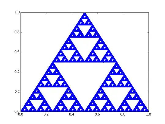

I have been learning how to make the basic example, to produce the Sierpinski triangle attractor. For instance this is a very basic Python test result:
I have generated the attractor by doing $100000$ iterations following the basic rules: (1) generate a random value from $1$ to $6$ (the equivalent of throwing a dice and getting a value), then (2) if the random value is $1$ or $2$, the next point will be at half distance of the vertex $(0,0)$, if it is $3,4$ the next point will be at half distance of the vertex $(0.5,1)$ and if it is $5,6$ the next point will be at half distance of the vertex $(1,0)$.

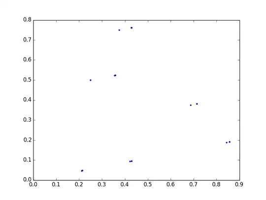

For instance I tried for step (1) as follows: iterating $n$ from $1$ to $100000$, the (false) random value is $((n\ mod\ 6)+1)$ and then applying step (2). In that case the attractor / fractal do not appear (as expected), only some scattered points. There is not randomness in sequence used to generate the random values of the "dice". Here is the result:

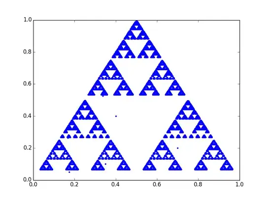

I did the exercise, using for step (1) the Möbius function to simulate the dice, by doing $1000000$ iterations following the basic rules for step (2): if $\mu(n)=-1$, the next point will be at half distance of the vertex $(0,0)$ (like getting a random $1$ or $2$ from a dice), if $\mu(n)=0$ the next point will be at half distance of the vertex $(0.5,1)$ (like getting a random $3$ or $4$ from a dice), and if $\mu(n)=1$ the next point will be at half distance of the vertex $(1,0)$ (like getting a random $5$ or $6$ from a dice). And this is the result, the Sierpinski attractor appears as well (more noisy, but the structure of the fractal is quite visible):
