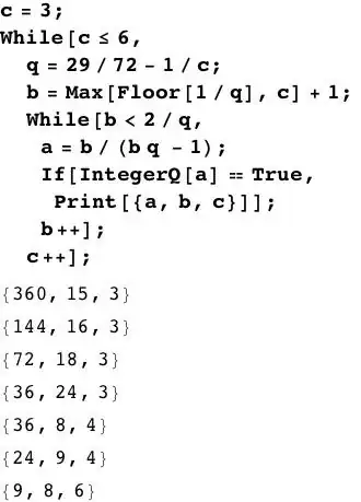

Given $c$ in this range, put $$q:={29\over 72}-{1\over c}\ .$$ We then have to solve $${1\over a}+{1\over b}=q\ .$$ The conditions for $b$ are $$b>c,\qquad {1\over b}<q, \qquad {1\over b}>{q\over2}\ ,$$ the third of these in order to guarantee $a>b$. This enforces $$\max\left\{{1\over q},c\right\}<b<{2\over q}\ .$$ Given $b$ in this range we have to check whether the resulting $$ a={b\over bq-1}$$ is integer. If yes, we accept the triple $(a,b,c)$. Mathematica found $7$ such triples, three of which violated the extra condition $a<60$. Here is the output:
  • So only 4 satisfy all requirements, which I got also by another long-ish (not clever) method. +1, still wonder if there is some clever way without trying so many cases... – coffeemath Jul 22 '15 at 12:53
