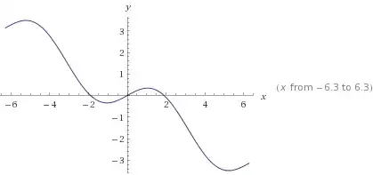

Of course $\beta=0$ is a solution, but I guess you should call it trivial. Setting $\beta/2=x$, you can realize what is going on by looking at the graph of $y=\sin x - \frac{x}{2}$. You will see that two more solutions exist (the function is trivially odd in $x$). You will never find a closed form in terms of elementary functions, so all you can do is to prove that they exist and to estimate them by some numerical method. enter image description here
