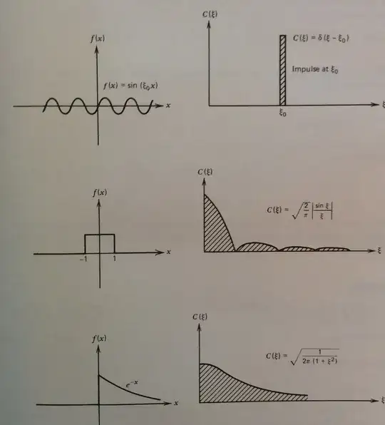

The author proceeds to give some examples, shown below:
Now, while I understand this mathematically, my intuition is severely lacking. My question is:
