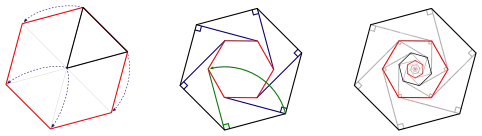

For those of you who would like a construction in which the relative sizes are more apparent, observe that existence of an equilateral triangle with vertices in $\mathbb{Z}^2$ implies existence of a regular hexagon with the same property, and that in turn implies an infinite sequence of smaller and smaller regular hexagons:
$\hspace{30pt}$hexagons
I once saw this method applied just for hexagons, but was unable to find the source (if someone knows it, I would be grateful for the reference).

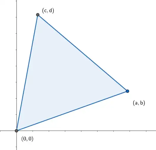

WLOG, let one of the vertices lie at the origin. We then have that the square of the three lengths are given by:
$$\begin{align}a^2+b^2=c^2+d^2&=(a-c)^2+(d-b)^2\\&=a^2+b^2+c^2+d^2-2(ac+bd)\end{align}$$
We can assume that not all $a,b,c,d$ are even, otherwise there is a smaller equilateral triangle. Now let's consider some cases:
  • $a^2+b^2\equiv_4 1\iff c^2+d^2\equiv_4 1$. This yields $$a^2+b^2+c^2+d^2-2(ac+bd)\equiv_4 2(1-ac-bd)$$ This is impossible.
  • $a^2+b^2\equiv_4 2\iff c^2+d^2\equiv_4 2$. This yields $$a^2+b^2+c^2+d^2-2(ac+bd)\equiv_4 2(ac+bd)\equiv_4 0$$ This is also impossible.
