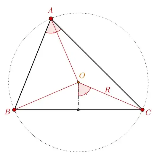

Since the sine theorem implies: $$\sum_\text{cyc}a\sin A = \frac{1}{2R}\sum_\text{cyc}a^2 \tag{1}$$ we just need to prove: $$ \sum_\text{cyc} a \cos A = \frac{abc}{2R^2}=\frac{2\Delta}{R}\tag 2$$ that is trivial since twice the (signed) area of the triangle made by $B,C$ and the circumcenter $O$ is exactly $aR\cos A$:
