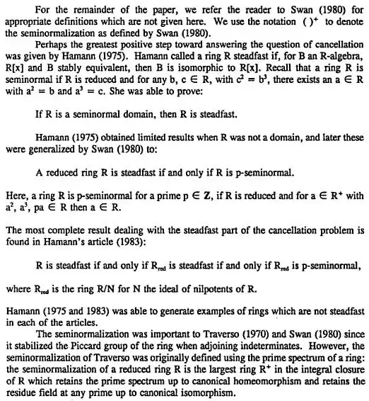

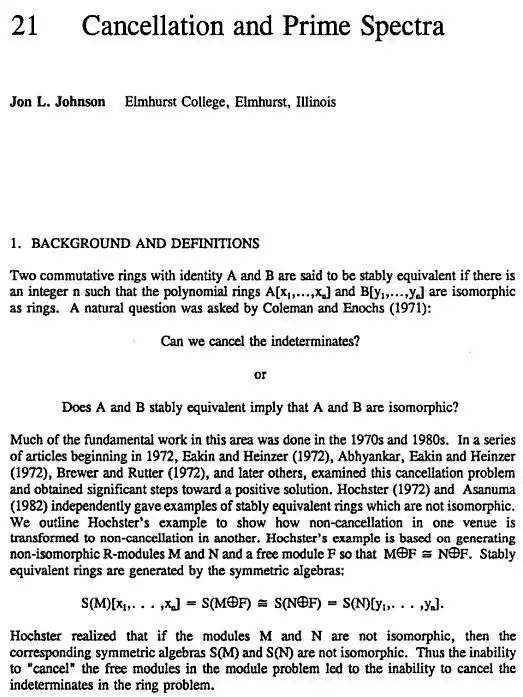

There's been much work on this problem since the mentioned seminal work in the early seventies. Searching on the buzzword "stably equivalent" should help locate most of it. Below is a helpful introduction from Jon L Johnson: Cancellation and Prime Spectra alt text alt text
