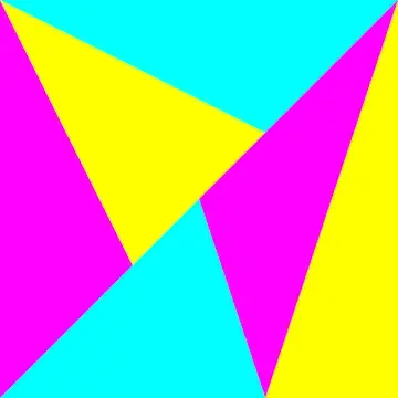

This may be an important insight into Monsky's problem that the natural topology on $[0,1]^2 \subset \mathbb{R}^2$ for this problem. Using the 2-adic norm, Monsky paritions the unit square into 3 subsets:
  • $A = \{ (x,y): ||x|| < 1 \text{ and } ||y|| < 1\;\;\;\;\,\}$
  • $B = \{ (x,y): ||x|| > 1 \text{ and } ||x|| > ||y||\}$
  • $C = \{ (x,y): ||y|| > 1 \text{ and } ||y|| > ||x||\}$
In Euclidean norm, these subsets (representing vertices of triangles) are dense in the unit square
Think about it -- it's very easy to draw a partition of a square into triangles. How can it be that none of them have equal area? You could try to draw an arrangement of triangles with some parameters; then they have some relationship which you can solve for. Monsky shows even with those equations you can find no solution.
