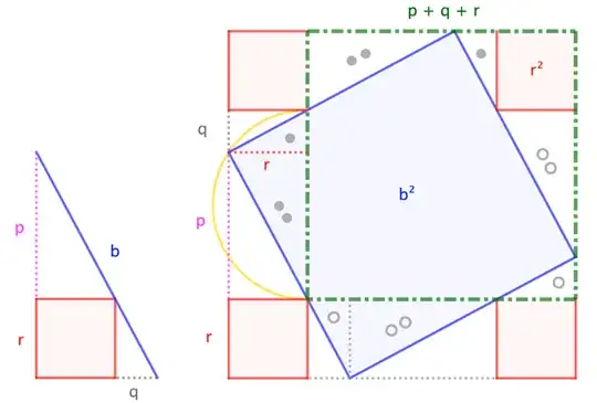

EDIT (5.5 years later!)
Had I known my solution would be featured in the video "Ladder and Box Problem" on Presh Talwalkar's "Mind Your Decisions" YouTube channel (thanks, Presh!), I would've made another pass.
Shunting the original solution to this answer's edit history, here's something of a streamlined presentation.
From a length-$b$ ladder resting against a side-$r$ box, we can make the following diagram:
Then we have:
$$\left(\;\color{green}{p + q + r} \;\right)^2 = \color{blue}{b}^2 + \color{red}{r}^2 \qquad\to\qquad p + q + r = \sqrt{b^2 + r^2} \tag{1}$$
(discarding the negative root). The semicircle recalls the classical construction of the geometric mean, and we have $$pq=r^2 \tag{2}$$
Now, $p$ and $q$ are the roots of the quadratic $$0 \;=\; (x-p)(x-q) \;=\;x^2 - (p+q)x + p q \;=\; x^2 - (-r + \sqrt{b^2+r^2})x + r^2 \tag{3}$$
Solving yields
$$\{p,q\} = \frac12 \left(-r + \sqrt{b^2 + r^2} \pm \sqrt{ b^2 - 2 r^2 - 2 r \sqrt{b^2 + r^2}} \right) \tag{$\star$}$$
For $r=1$ and $b=4$, this gives
$$\{p,q\} = \frac12 \left(-1 + \sqrt{17} \pm \sqrt{ 14 - 2\sqrt{17}} \right)$$
Calculating the "bigger cathetus" from this is left as an exercise to the reader.

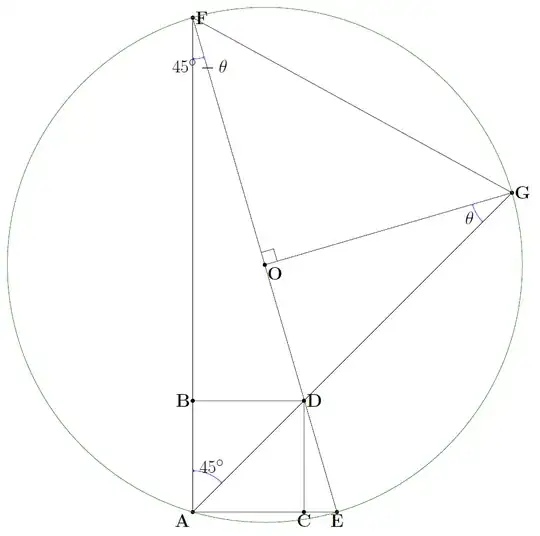

Expanding on the original diagram (see below), observe that if we draw a circle centred at point $O$ with $\overline{EF}$ as a diameter, then point $A$ is on the circle. We also construct point G such that $\overline{OG} \perp \overline{EF}$. Furthermore, since $\angle{FOG}$ is a right-angle, $\angle{GAF}$ is $45^\circ$ as labeled, so points $A,D,G$ are collinear.
Using the fact that the power of point D relative to the circle is invariant, we have
$(AD)(DG) = (FD)(DE) = (FO + OD)(OE - OD)$
Since $AD = \sqrt{2}$ and $OF=OG=2$, then $DG = 2 \sec{\theta}, OD = 2 \tan{\theta}$, so
$\sqrt{2} (2 \sec{\theta}) = (2 + 2 \tan{\theta})(2 - 2 \tan{\theta}) = 4 - 4 \tan^{2}{\theta} = 8 - 4 \sec^{2}{\theta}$.
Put $w = \sec{\theta}$ to reduce to $4 w^2 + 2\sqrt{2}w - 8 = 0$ and taking the positive root $w = \frac{-\sqrt{2} + \sqrt{34}}{4}$ from which $\cos{\theta} = \frac{1}{w} = \frac{4}{\sqrt{34} - \sqrt{2}}$, so $\theta \approx 0.437896 \text{ rad }$ and $AF = 4 \cos{(\frac{\pi}{4} - \theta)} \approx 3.7609$
Elaboration of original diagram showing additional geometry
