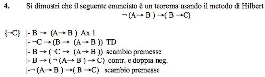

I'm looking for an actual step-by-step way of proving that a statement is a theorem using Hilbert's system. For instance:
As can be seen from the above picture, the solution consists in a series of steps starting from one of the three axioms (I can only use P2, P3 and P4 and Modus ponens from this https://en.wikipedia.org/wiki/Hilbert_system#Logical_axioms). However, how do I know which axiom to start with? Should I go backwards, starting from the actual statement provided and work my way until I find an axiom? I've also seen ways where you use Modus Ponens (a, a->b/b), but it's unclear exactly the process.
Can anybody help me with the actual step-by-step process on how to do this?
