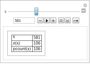

Prime counting 01
Manipulate[
 Module[{panel, p1, p2, pcount},
  p1[x_] :=
   Module[{k, i, sum, sum1, sum2, sum3, sum4, sum5, sum6},
    k = Floor[(x - 1)/6];
    sum1 = (i = 1; sum = 0;
      While[6*i^2 - 2*i <= k, sum += Floor[(k + i)/(6*i - 1)] - i + 1;
        i++]; sum);
    sum2 = (i = 1; sum = 0;
      While[6*i^2 + 2*i <= k, sum += Floor[(k - i)/(6*i + 1)] - i + 1;
        i++]; sum);
    sum3 = (i = 0; sum = 0;
      While[i <= (k - 29)/25,
       sum += Floor[(k + 5*i + 6)/(30*i + 35)] - 1; i++]; sum);
    sum4 = (i = 0; sum = 0;
      While[i <= (k - 29)/35, sum += Floor[(k - 5*i - 4)/(30*i + 25)];
        i++]; sum);
    sum5 = (i = 0; sum = 0;
      While[i <= (k - 64)/35,
       sum += Floor[(k + 7*i + 13)/(42*i + 77)] - 1; i++]; sum);
    sum6 = (i = 0; sum = 0;
      While[i <= (k - 57)/49,
       sum += Floor[(k - 7*i - 8)/(42*i + 49)] - 1; i++]; sum);
    k - sum1 - sum2 + sum3 + sum4 + sum5 + sum6
  p2[x_] :=
   Module[{km, i, sum, sum1, sum2, sum3, sum4, sum5, sum6},
    km = Floor[(x + 1)/6];
      While[i <= (km + 1)/7, sum += Floor[(km - i)/(6*i - 1)]; i++];
      sum);
    sum2 = (i = 0; sum = 0;
      While[i <= (km - 21)/25,
       sum += Floor[(km + 5*i + 4)/(30*i + 25)] - 1; i++]; sum);
      While[i <= (km - 41)/35,
       sum += Floor[(km - 5*i - 6)/(30*i + 35)]; i++]; sum);
       sum += Floor[(km + 7*i + 8)/(42*i + 49)] - 1; i++]; sum);
    km - sum1 + sum2 + sum3 + sum4
  pcount[x_] := 2 + p1[x] + p2[x];
  panel =
   Panel@Column[{
      Grid[{
        {"x", x}, {"\[Pi](x)", PrimePi[x]}, {"pcount(x)", pcount[x]}
        }, Alignment -> {Left, Top}, Frame -> All]
  panel
 , {{x, 301}, 1, 1500, 1, Appearance -> "Open"}
I've found interesting the fact that you don't need to rely on Primes table nor need of trial division.
Although the range $x\leqslant 874$ (in fact, it also works for range $1001\leqslant x\leqslant 1224$) is quite small, I think that the formula can be extended to any range by adding necessary sums, but it then becomes difficult to avoid duplicates counts.
EDIT1: some people misunderstood "by adding necessary sums". I mean in fact that I'm quite sure that $p1(x)$ and $p2(x)$ valid for any $x$ can be written in the form of a closed single double-sum of $k$ (i.e: $pn(x)=\sum \sum f(k)$ ).
I didn't find anything on the net about this or similar kind of formula. Does anybody know something about?
