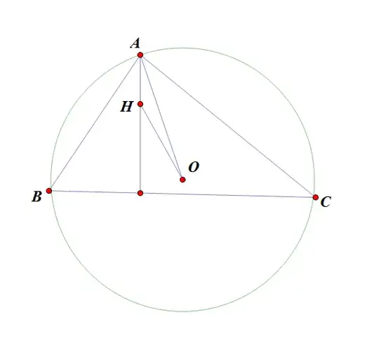

since $$\angle HAO=|B-C|.OA=R,AH=2R\cos{A}$$ use cosin theorem we have \begin{align*} OH^2&=AH^2+AO^2-2AH\cdot AO\cos{|B-C|} =4R^2\cos^2{A}+R^2-4R^2\cos{A}\cos{(B-C)}\\ &=5R^2-4R^2\sin^2{A}+4R^2\cos{(B+C)}\cos{(B-C)}\\ &=9R^2-4R^2(\sin^2{A}+\sin^2{B}+\sin^2{C})\\ &=9R^2-(a^2+b^2+c^2) \end{align*}
