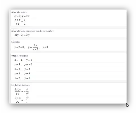

Hence only integer values in the range $-2 \le x \le 6$ can result in an integer pair $(x,y)$. Let us check the list of candidates. We find that $(-2, 1)$, $(0,0)$, $(1, -2)$, $(3,6)$, $(4,4)$, $(6,3)$ are the only solutions.

Summary: Taking into account we've supposed $x\ge y$, there are $5$ solutions: $$\bigl\{(1,-2), (-2,1), (4,4), (6,3), (3,6)\bigr\}.$$
