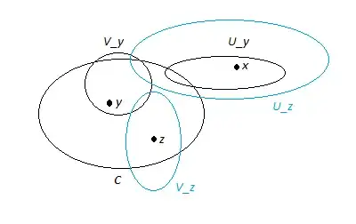

Here’s a sketch that may help a little.
The large black oval represents the compact set $C$, $x$ is the point outside $C$, and $y$ and $z$ are two points of $C$ that I’ll use to illustrate the choice of open nbhds. The space is Hausdorff, so $x$ and $y$ have disjoint open nbhds; in the picture they’re the smaller black ovals, $V_y$ being the nbhd of $y$, and $U_y$ the corresponding nbhd of $x$. Similarly, $x$ and $z$ have disjoint open nbhds; I’ve drawn them in blue, $V_z$ being the nbhd of $z$, and $U_z$ being the corresponding nbhd of $x$.
