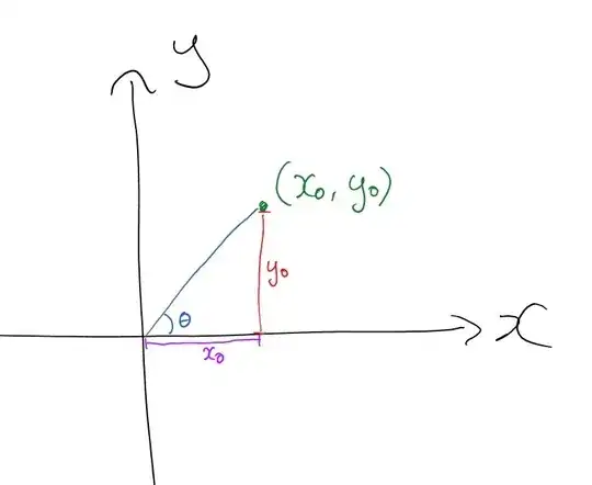

Does the picture below help you visualise this? By 'angle' we mean $\theta$ below in plane polar coordinates. For some point $(x_0,y_0)$ on the plane, we can solve for $\theta$ using trigonometry.
Diagram
  • Thanks art pictures. Yes so I asking about can we know the angle from any other tri- functions. – gmotree Jun 16 '15 at 09:09
    This answer would be improved my including the actual trig to get theta from x0 and y0 here. – lindes Jun 01 '18 at 04:41
