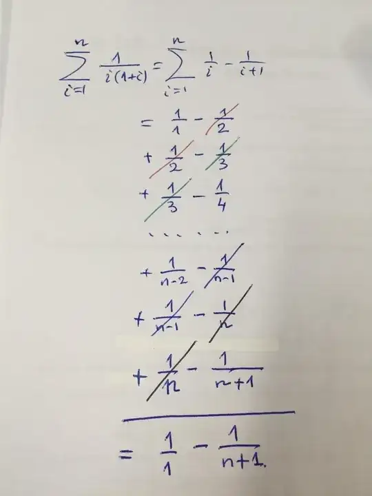

  • @sempiedram. You are welcome. You can improve the presentation: instead of one line use two columns (the left one contains the $1/i$ values and the right one contains the $-1/(i+1)$ values, and the cancellation would be in diagonals, its beautiful ! – Idris Addou Jun 16 '15 at 03:20
  • Yes, quite interesting how it works. – sempiedram Jun 16 '15 at 03:53
Telescoping sum Here is a picture showing the two columns and the cancellations in diagonals
