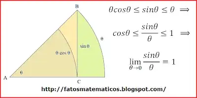

A To prove $\displaystyle\lim_{x \to \infty} \frac{\sin x}{x} = 1$ just look at the wedge of a circle and notice the the arc and the height are about the same. With an appropriate change of angles you can get
I think in your cases it might be useful that $\displaystyle \lim_{x \to 0} \frac{\tan x }{x} =1$
