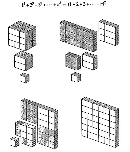

The clearest proof I've seen is this one, which comes from here: you just have to stare at it for a few seconds to see how it works. (It's a variant of the other proofs, of course, but actually has cubes in it.)
Animation

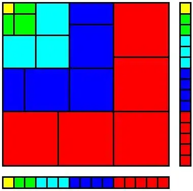

There is this picture. Here, they represent $x^3$ as $x$ squares of side length $x$. The big square is the sum of all numbers up to $x$.
page 86 ,85
book :proof without words
author : roger nelsen
you can find here many kind of this proof enter image description here

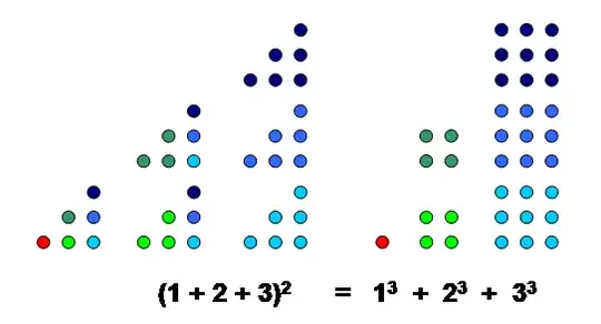

This identity is sometimes called Nicomachus's theorem. If you type this in google, you'll recieve numerous pictures.
1. enter image description here
2.enter image description here
3.enter image description here
